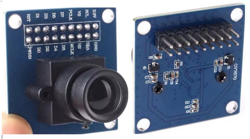

2.2 OV7670 camera hardware and waveform situation
The OV7670 module used is as follows:
Fig 2
Pin situation
No
Signal
Description
1
PWDN
Power consumption selection mode, pull down for normal use
2
RET
Reset port, pull high for normal use
3
D0
Data port output bit 0
4
D1
Data port output bit 1
5
D2
Data port output bit 2
6
D3
Data port output bit 3
7
D4
Data port output bit 4
8
D5
Data port output bit 5
9
D6
Data port output bit 6
10
D7
Data port output bit 7
11
XLK
Clock signal input signal
12
PLK
Pixel clock output signal
13
HS
Horizontal synchronization signal output signal
14
VS
Frame sync clock output signal
15
SDA
SCCB Interface data control
16
SCL
SCCB Interface clock control
17
GND
GND
18
3.3V
3.3V power

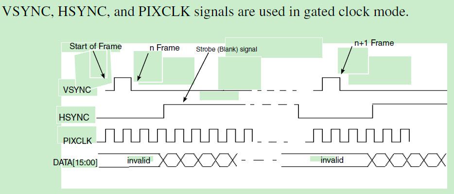

RGB565 output data timing:
Fig 3
2.2 CSI frame synchronization signal timing waveform
Fig 4
2.3 LCD display wave
Fig 5
Therefore, the data of OV7670 is obtained through CSI and then stored in the buffer. The eLCDIF then retrieves the data from the buffer and displays it on the LCD screen to display the real-time collection and reality of the camera data.

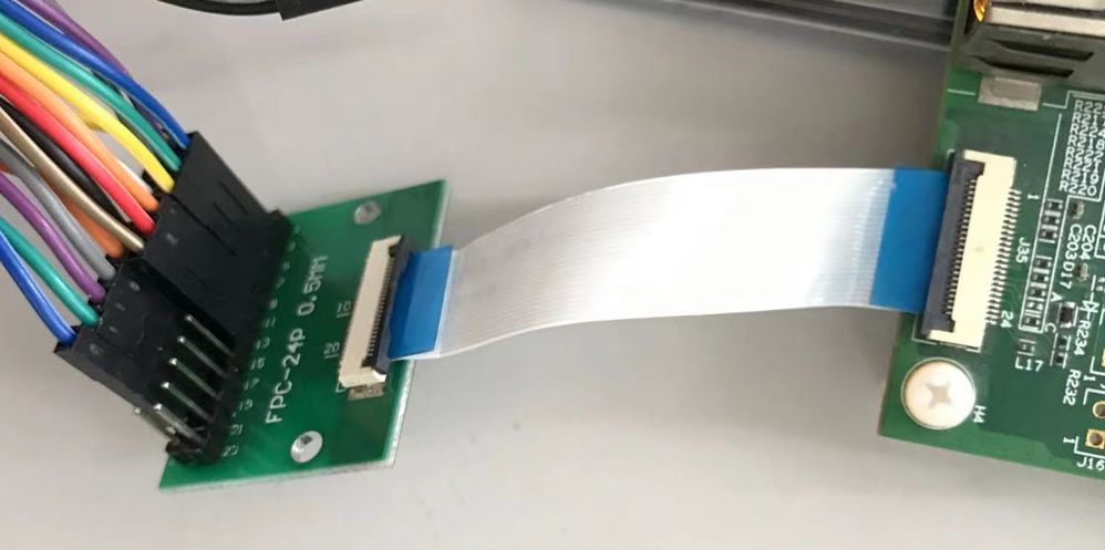

3.1 Hardware connection
As can be seen from Figure 2, the universal module purchased is a 2.54mm direct plug mode, but the CSI interface used on the MIMXRT1050-EVKB board is an FPC interface, so an adapter board is required to switch from FPC to 2.54mm direct plug mode. The wiring diagram is as follows:
Fig 6
The actual overall hardware connection situation is as follows:
Fig 7
