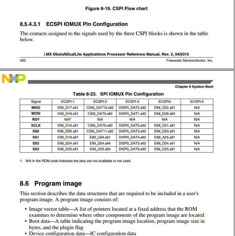

When my imx6solo board boot from spi nor flash32MB by standard operation,it is ok,but can not boot from dual spi,why?
Where is the code or driver to boot from dual spi nor falsh?

i.MX6S does not support boot from dual/quad spi, only single spi nor is supported.
Please refer to i.MX6SDL Reference Manual Table 8-23. SPI IOMUX Pin Configuration
for connections for spi-nor.
http://www.nxp.com/assets/documents/data/en/reference-manuals/IMX6SDLRM.pdf
igor

But ago,someone said solo do not support quad-spi,but support dual spi.
Where is the reference design of imx6 solo?
Also,I find that solo's RM pdf only has SPI IOMUX PIN configuration table,it is not show solo do not support dual or quad spi.but imx6-quad has quadspi chapter and do not show it support dual spi. I am missing.
