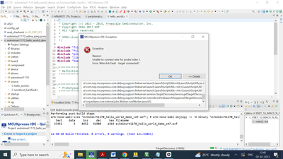

unable to connect wire for probe index 1 in while debuggine mimxrt1170

iam getting the above error while debgging the rt1170evk board

I recommend reviewing the information on the page for the first use. Maybe need the external DC, it does not have an external DC please modify the power selection jumper or the boot source switch is wrong. The next link show, which is the USB for debugging, or if you are using an external debugger need an adapter to connect un the JTAG [J1].

i boot the the rt1170 its working fine thanks for the reply
