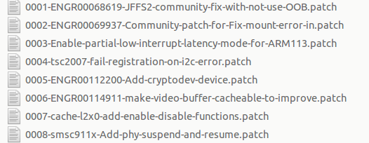

caohaifeng
How can I check what I have patched ? I have download this file, but I don't know whether I have patched it.
and I have patched some files like this .0081-ENGR00125856-1-MX53-eSDHC-iomux-updates-when-iomux-V.patch
1,001 Views
jimmychan
There is a PDF MX53_LINUX_BSP_201112_Patch_release. You can follow the instructions to apply the patches.
