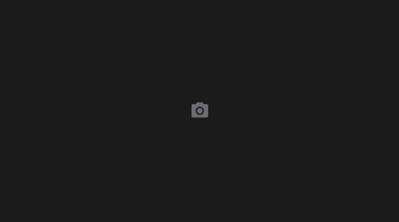

imx8qxp, open the Android camera application, the preview interface has no content
2,388 Views
relax-wu
Who can help me?
SDK:Android Q10.0.0_2.2.0_AUTO
nvp6324 connect 4 cameras
The evs function of the product mek_8q_car-userdebug has been adjusted, but the camera apk cannot be used to open the camera.
Therefore, I switched the product to mek_8q-userdebug to test the traditional method of using the camera, and I am currently experiencing problems:
The camera apk opens and previews no content.

main error log
03-26 02:12:12.937   433  2408 E Camera3-Stream: getBuffer: wait for output buffer return timed out after 8000ms (max_buffers 2)
03-26 02:12:12.938   433  2408 V Camera3-Stream: getBuffer: Already dequeued max output buffers (2), wait for next returned one.

Zhiming_Liu
The error happened in CameraHAL.Failed in below command.You need see if your camera support VIDIOC_DBG_G_CHIP_IDENT.
ret = ioctl(fd, VIDIOC_DBG_G_CHIP_IDENT, &vidChip);

relax-wu
Please help to see how to solve it。
Here is the main problem
ret = ioctl(mDev, VIDIOC_S_PARM, &param);
if (ret < 0) {
    ALOGE("%s: VIDIOC_S_PARM Failed: %s", __func__, strerror(errno));
    return ret;
error log
E FslCameraHAL: onDeviceConfigureLocked: VIDIOC_S_PARM Failed: Not a typewriter
E FslCameraHAL: handleConfigureLocked onDeviceConfigure failed
in the kernel
//vendor/nxp-opensource/kernel_imx/drivers/staging/media/imx/imx8-isi-cap.c
static int mxc_isi_cap_s_parm(struct file *file, void *fh,
			      struct v4l2_streamparm *a)
	struct mxc_isi_cap_dev *isi_cap = video_drvdata(file);
	struct v4l2_subdev *sd;
	sd = mxc_get_remote_subdev(isi_cap, __func__);
	if (!sd)
		return -ENODEV;
	return v4l2_s_parm_cap(video_devdata(file), sd, a);
Did not call nvp6324_s_parm。
The following three functions are called
.enum_frame_size = nvp6324_enum_framesizes,
.get_fmt = nvp6324_get_fmt,
.set_fmt = nvp6324_set_fmt,

relax-wu
I saw another problem I was trying to solve
2,355 Views
relax-wu
I have solved this problem,
--- a/android_build/vendor/nxp-opensource/kernel_imx/drivers/staging/media/imx/imx8-isi-cap.c
+++ b/android_build/vendor/nxp-opensource/kernel_imx/drivers/staging/media/imx/imx8-isi-cap.c
@@ -1170,6 +1170,15 @@ static int mxc_isi_cap_s_selection(struct file *file, void *fh,
        return 0;
+static int mxc_isi_cap_g_chip_ident(struct file *file, void *fh,
+                                       struct v4l2_dbg_chip_ident *chip)
+       chip->match.type = V4L2_CHIP_MATCH_I2C_DRIVER;
+       strcpy(chip->match.name, "nvp6324_mipi_camera");
+       return 0;
 static int mxc_isi_cap_enum_framesizes(struct file *file, void *priv,
                                       struct v4l2_frmsizeenum *fsize)
@@ -1285,6 +1294,7 @@ static const struct v4l2_ioctl_ops mxc_isi_capture_ioctl_ops = {
        .vidioc_g_selection             = mxc_isi_cap_g_selection,
        .vidioc_s_selection             = mxc_isi_cap_s_selection,
+       .vidioc_g_chip_ident    = mxc_isi_cap_g_chip_ident,
        .vidioc_enum_framesizes = mxc_isi_cap_enum_framesizes,
        .vidioc_enum_frameintervals = mxc_isi_cap_enum_frameintervals,
The preview interface still has no content。
