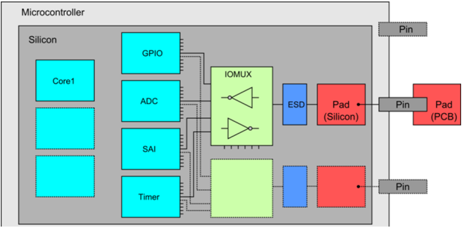

BiyongSUN
The pull up on data0 and command lines are used for "in case".
In case, there is some hardware layout issue for example need to debug hardware.
add the external pull up can make the ware form better in case layout has issue.
When you debug hardware, you can use the 1 bit mode for emmc. that is why you can see the pull up only on data0.
also suggest you can add one  0 ohm series resistor in the clk "in case" need to debug the hardware for timing issue, which also may be caused by layout sometime.  You can adjust that series resistor.
The pad/pin settings are independent as show below picture. no related to GPIO. related to IOMUX.
The GPIO, ADC, SAI are equal.(In blue of the picture). they only take of care of logic "0" or "1"
The pads/pins(silicon ) is in red.

diegoperez
Thaks for your reply @nxf63675
In my emmc datasheet says this:
So I need 50K as maximun (I am using 1.8V) in all signals, I am thinking to use the internal pull ups of the imx8mp, that in the datasheet says that the maximun value is 49K.
I have a simple question, pull up configuration is associated to the GPIO function or is independent and can be used when USDHC3 peripheral is working with these pads?

nxf63675
Hi @diegoperez,
Well, depends on the way you configure your PAD but simply, the answer is yes, as these pins can be used as a GPIO.
