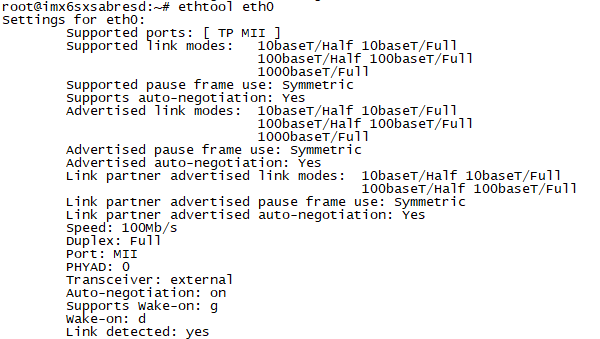

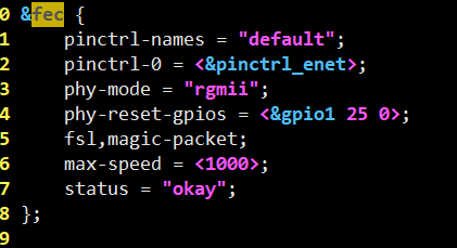

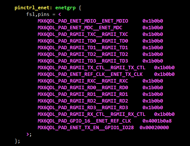

my imx6q custorm board (Linux version 4.1.15)  with AR8035. the network  runs steadily in 10M and 100M.
but can't reach 1000M.
when i switch the network to 1000M,the systerm was dead.
in this moment,the RGMII_TX_CLK is null but RGMII_RX_CLK can up to 128M.

   when i switch the network to 10M/100M ,the RGMII_TX_CLK and RGMII_RX_CLK is 2.5MHz/25MHz. the ENET_REF_CLK is 125M. then switch the network to 1000M ,the RGMII_RX_CLK is 125M RGMII_TX_CLK is null ENET_RET_CLK is 125M.I am puzzled about that.
