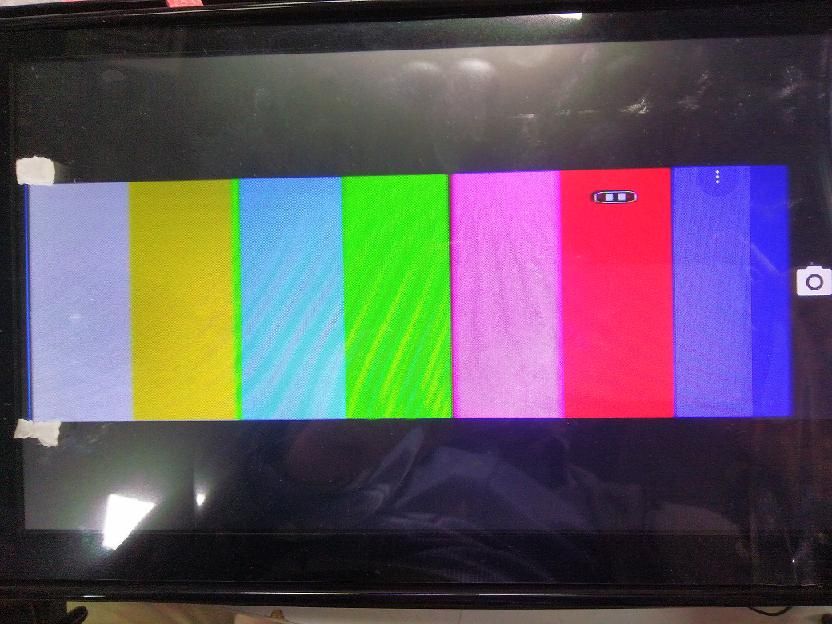

I want to full screen display now,But unsuccessfulHow to set up software?
my software settings are as follows
   p->if_type = V4L2_IF_TYPE_BT656; /* This is the only possibility. */
    p->u.bt656.mode = V4L2_IF_TYPE_BT656_MODE_NOBT_8BIT;
    p->u.bt656.nobt_hs_inv = 0;
    p->u.bt656.bt_sync_correct = 1;     //use gated mode
    p->u.bt656.clock_curr = 37000000;
As the pixel after conversion through tp2825 is  960*624,The input of tp2825 A/D is STD CVBS PAL。
Use  param below:
Parameters are modified below,The image is displayed as follows:
   {            /*! (B, G, H, I, N) PAL */
     .v4l2_id = V4L2_STD_PAL,
     .name = "PAL",
     .raw_width = 960,
     .raw_height = 624,
     .active_width = 960,
     .active_height = 312,
     .active_top = 0,
     .active_left = 0,
     .name = "PAL",
     .raw_width = 960,
     .raw_height = 624,
     .active_height = 624-16
     .active_top = 0,
     .active_left = 0,

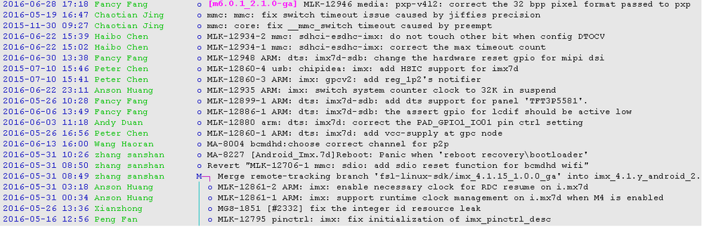

Hi feng
please try interlaced-mode-capture patch on
https://community.nxp.com/docs/DOC-158531
igor

liangfeng_0824
hi  igorpadykov
I am using i.MX6DualLite  android6.0.1  now, Please specify that I should use that
The project is more urgent, need your help,tks!
875 Views
liangfeng_0824
Which patch should I use?

liangfeng_0824
I now use the i.MX6DualLite  android6.0.1  kernel software version is :
Please confirm which patch I should use now?
