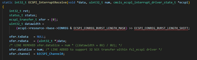

Encountered the following issue with the iMX8 SPI after moving from fsl_ecspi.c driver to fsl_ecspi_cmsis.c driver.  fsl_ecspi_cmsis.c driver being top layer above the fsl_ecspi.c driver.

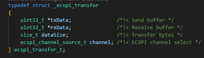

iMX8 SPI FIFO is 64 entries deep 32 bits wide (4 bytes wide).  The fsl_ecspi.c driver treats all transfers as 32-bit wide, as seen below.
In my application, I needed to receive 76 bytes, which is 19 32-bit transfers.  I called CMSIS method ECSPI_InterruptReceive() with data pointer to 76 bytes and num equal to 19.  Burst Length is configured to 32 (32 is stored as 31 in hardware register).  ECSPI_InterruptReceive() calculates xfer.dataSize to equal 76 under this situation [76 = 19 * ((31 + 8)/8)].  xfer.dataSize equal 76 causes SPI receive interrupt to perform 76 32-bit transfers into data pointer and therefore causes memory corruption because data pointer only points to 76 bytes.  Changing ECSPI_InterruptReceive() as below for xfer.dataSize equal to 19 resolved my issue.  xfer.dataSize equal to 19 causes SPI receive interrupt to perform 19 32-bit transfer into data pointer, which is the correct 76 bytes.

I really do not have any error logs to share beyond what I posted.  With the posted modification to ECSPI_InterruptReceive() my application appears to be functioning correctly.  I just wanted to share a modification that I needed to implement.
