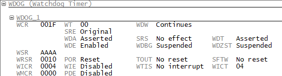

The problem is that the wdog1_rst_b_deb is not getting asserted. It is configured as such, but doesn't react. Please find the configuration  after bootup below:

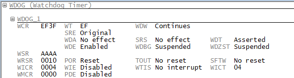

Here is the watchdog register after sending a "echo b >/proc/sysrq-trigger" to trigger the watchdog, the system hangs up at this point because no external reset takes place. The wdog1_rst_b_deb external pin remains logical HIGH.
Can you please give an advice what prevents the pin from getting asserted?
Another problem is that the processor seems to loose informations about the reset cause, it displays POR on following startup, not WDOG. For sure it looses this information because of the power cycle. Do you have a solution for that?

philipp_blumberg
Hi Igor,
which bit are you exactly talking about? When setting SRS bit, it doesn't matter if wdog_rst_b_deb is configured as such or not, the pin will fall low (due to internal driver shutdown). It doesn't get asserted intentionally. WDA bit is set on watchdog triggering but the wdog_rst_b_deb bin remains high
Kind regards,
Philipp
