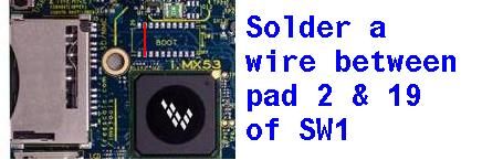

Is there a GPIO pin that can choose which mmc interface to boot up ?

To boot from SD3 (Full size SD Card socket), the "short" answer is to solder a wire between pads 2 & 19 of SW1. See picture. For more detail, see section 5.4.2 of the HW User Guide. The SW1 footprint was designed for a Multicomp MCNHDS-10-T Dip switch.

SD port select option BOOT_CFG3[5:4] (EIM_DA6, EIM_DA7) may be configured on (BOOT) SW1
of the QSB. Please use the scheme for details.
Also one may look at section 5.5.2 (Boot Mode Operations and Selections)
of “Hardware Reference Manual for i.MX53 Quick Start”.

According to Table 7-15 (ESDHC Boot eFUSE Descriptions) of i.MX53 Reference
Manual (RM), BOOT_CFG3[5:4] fuses are responsible for SD port selection.
Table 7-3 (GPIO Override Contact Assignments) of the RM shows what pins
may be used instead of fuses.
http://cache.freescale.com/files/32bit/doc/ref_manual/iMX53RM.pdf
