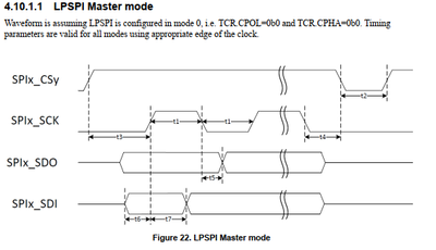

In the datasheet, the LPSPI timing is illustrated with CS active high.

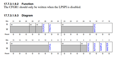

In the reference manual, the default value for CS polarity is active Low.
(CSPOL:00b)
Why is CS shown as active high in the data sheet?
I don't think it is common to use CS in Active High; does NXP's promotion of Active High convey any important message to me?

In 4.10.1.1, Despite the example of CPOL = 0b0, the CS in the timing chart is depicted as active high. Why are the assumptions and the diagram different?
Is NXP intentionally reversed in any way?
2,
Do you mean that the timing of 4.10.1.1 is promised any polarity?

1. CPOL sets the polarity of Clock and CSPOL sets the polarity for CS. Kindly refer to the description of CPOL in Section 17.7.3.1.15.4 of Reference Manual.
2. As mentioned in the datasheet, Timing parameters will be valid for all four modes using appropriate edge of the clock. Kindly refer to the attached image for further clarification.

Do I need to worry about the chart not being drawn with the polarity of the register reset value?
2,
I understood that the same timings apply in all 4 modes, not just the polarity in the chart.
