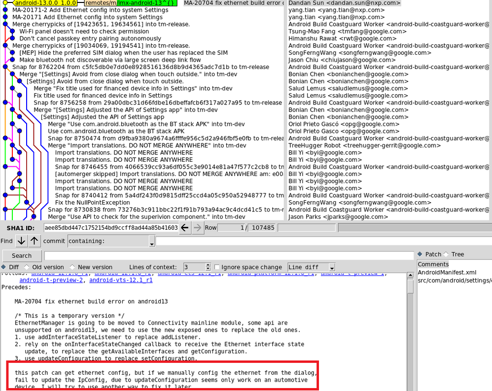

       I test the Ethernet function with android 13 on i.MX8 pluse evk. I found a problem about static ip. I cannot config the static ip after I had changed thet ethernet config dialog. Could you have any idea to solve this issue? Thanks.

       Could you have any update for this issue?  I check the android 13 BSP of NXP. I found that the commit message(aee85dbd447c1752154bd9ccff8ad44a85b41603) like below
this patch can get ethernet config, but if we manually config the ethernet from the dialog,
fail to update the IpConfig, due to updateConfiguration seems only work on an automotive
device, I will try to use another way to fix it later.
Is the issue solved now?
thanks.
What is the patch you mentioned? Could you share us the link?

rudolphhsueh
Hi NXP,
          This information I get in the i.MX8 BSP.
I cannot get new update to fix this issue after I run command "repo sync" for this BSP.
Is the issue solved?
