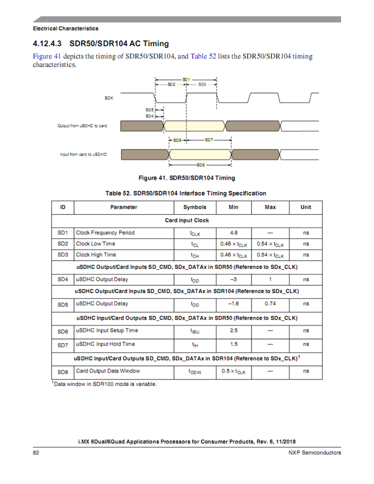

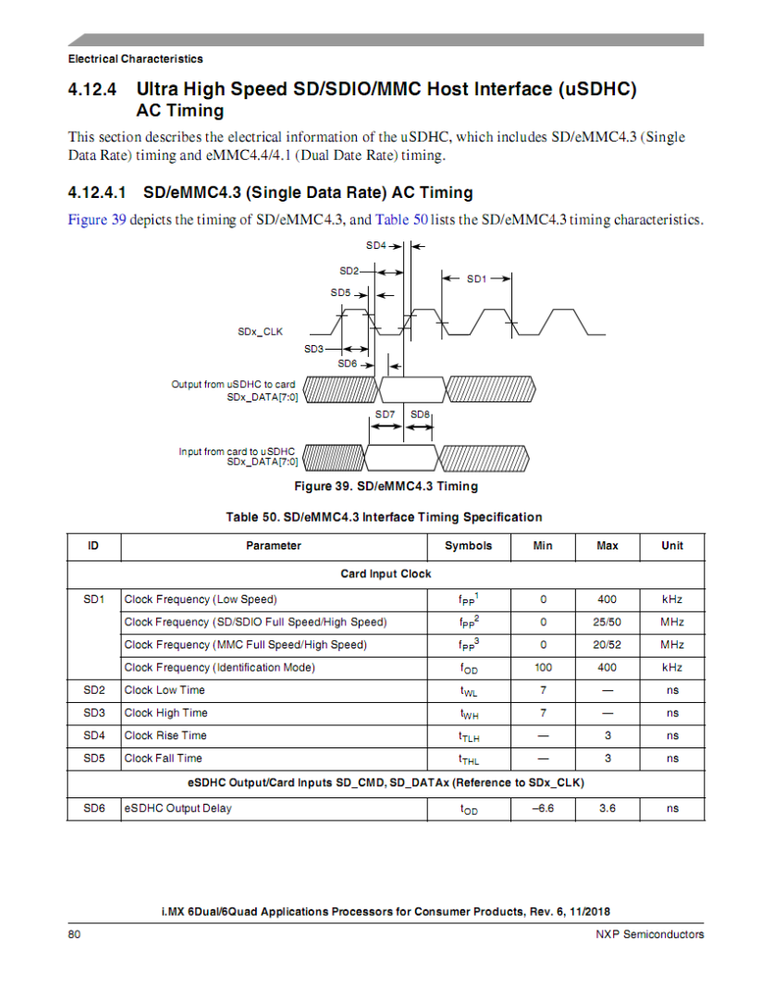

igorpadykov
Hi Andy
please check sect.4.12.4.4 Bus Operation Condition for 3.3 V and 1.8 V Signaling
i.MX 6Dual/6Quad Applications Processors for Consumer Products - Data Sheet
igor
