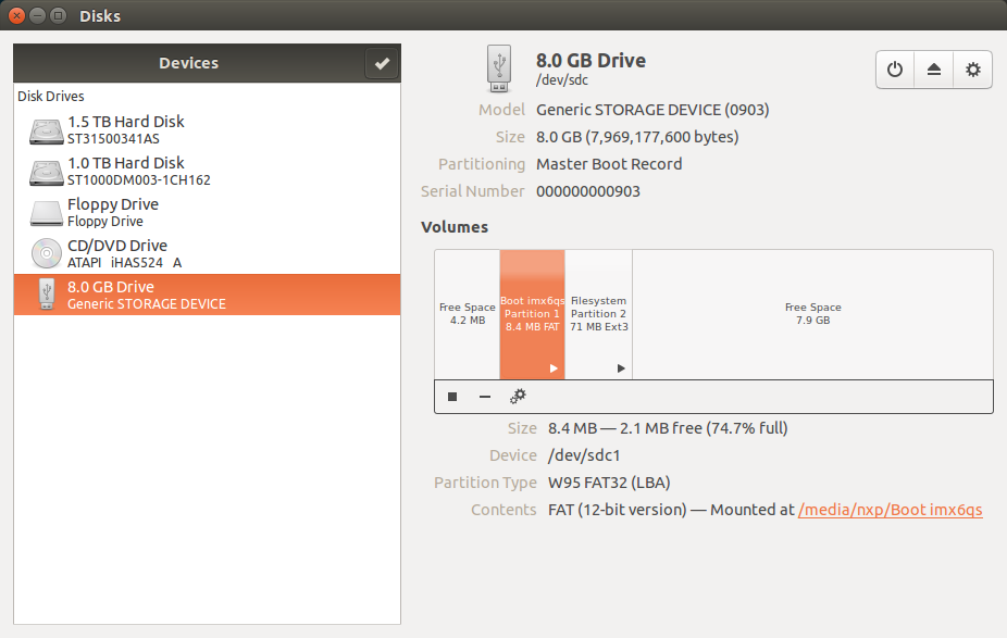

I am new to the NXP community and so I previously posted in the general community page. I am reposting here.
I have the SABRE board for smart devices  6QP.  I need to have the SDcard have the "core-image-base."
I used the Freescale Yocto Project User's Guide, Rev. L_3.14.38_6ul-ga, 09/2015 and successfully build the image and got all the files in ..MYNAME/tmp/deploy/images/imx6qsabresd.
I imaged the SD card as in Section 6.1:
THE DISK UTILITY SHOWS:   (Partition 2 has /bin /home, etc.)
But when I boot I get the following messages:

Hi Janet,
How you have created the SD card ?
The best way is "dd if=<path_to _generated_image> of=/dev/mmcblk* bs=4M" (* is 0, 1, 2, ...) or for windows exist Win32DiskImager tool.
Also you need chcek the setings of u-boot env with command "printenv" in u-boot shell if you have correct setings of boot arguments (SD card number)

jpe1313
Rita,
So, my problem was a bad SD card.  I've been up and running.  Now the next step is to take what I have on the SD card and get it onto the EMMC chip so I can boot from there.  I've got the MCIMX6Q-SDB evaluation board (imx6qsabresd).  I've read what you suggested.  I am posting another question about Using the eMMC to get some clarification. "Using eMMC on MCIMX6Q-SDB  (i.MX SATBE boards)"
