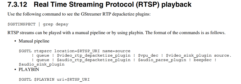

I'd like to Stream Camera Capture over IP Address on i.mx8m,
refer to 4.14.78 linux user guide:
but got the error below.
Could anyone give some direction?  Many thanks.

Hi felix
one can try with:
gst-launch-1.0 -v udpsrc ! application/x-rtp ! rtph264depay ! vpudec ! kmssink
gst-launch-1.0 -v udpsrc ! application/x-rtp ! rtpjitterbuffer ! rtph264depay !  queue ! vpudec ! queue ! kmssink
