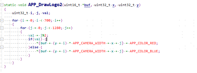

   您好:
         使用IMX8Q的cm4核外接lvds双通道屏,显示出现锯齿,怀疑是lvds通道的奇偶像素设置反了,请问那个寄存器是设置奇偶像素位的?

感谢您的回复:
   我们也发现不是奇偶像素问题,当lvds从单路模式改成split模式dpu需要有什么样的更改呢,我们配置的分辨率是1920实际显示的是他的2倍宽度,那么另外一半的像素数据从哪里获取的呢,还是dpu需要配置相应寄存器修改。

Since Android is OK for the display, I think the issue is caused by only one LVDS port had sent out data.
Note: When turning on split mode, only PHY clock should be divided by 2, others clocks need to be kept unchanged.
For your reference. Attached a reference patch for iMX8QM MEK.

957992093
8qm,现在我们发现用这种方式填充完后显示的是紫色,不是红蓝相间,请问dpu需要配置那个寄存器么,实现双lvds显示,请直接回答问题,谢谢!

jimmychan
On iMX8QM, for dual channel LVDS panel, port 0 is for first pixel and port 1 is for second pixel, it can't be switched.
So customer should connect the correct LVDS port between panel and iMX8QM.
