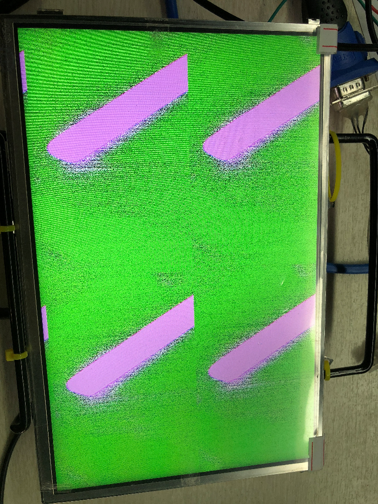

 Now I debug a board on imx6D by mipi connect to max9286 which connect 4 camera,and each camera base on max96705+AR0135 raw data 12bit output.Can the imx6D support the raw data? If it can,please tell me how to do?

Did anyone debug sucessfully on max9286-imx6 by raw 12bit data?
My IMX6D HDMI port outputs Four split screen as following pitcure,but the right way must display two split screen because I fill the display area with raw 12bit while display hdmi with YUV 422.Why it outputs four split screen?

seems these patches do not support raw format data, so image sizes:
please check img_width * img_height in mxc_v4l2_tvin_max9286 sources
 - should be appropriately defined for raw data.
