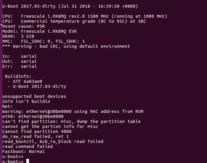

Hi community:
   I download the nxp Android8 repo source,
   and use the branch "imx-android-oreo "
   and "source build/envsetup.sh ","lunch evk_8mq-userdebug","make -j4"
   after build complete, I copy the "out/target/product/evk_8mq/u-boot-imx8mq.imx"  as  "mfgtools/Profiles/Linux/OS Firmware/firmware/imx-boot-imx8mqevk-sd.bin-flash_evk"
   finally, I burning to the imx8mq-evk board, but error at "Jumping to OS image":
   should i change something?
