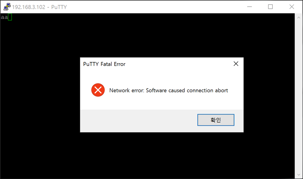

Hi All,
I'm using imxrt1060 evk board. I run simple modbus TCP server program using lwip socket on the board. I'm trying to test if the connection (or socket) is kept after I unplug and re-connect an Ethernet cable. If the connection is kept then modbus TCP client on PC can still communicate with the server. I expected the connection would be kept, but it wasn't. The unplugging Ethernet cable caused an error to the modbus client somehow so the connection seems lost. The modbus kept sending a packet but the server didn't receive any packet from the client. However, if I opened other modbus client program and connected it to the server then it could connect and send/receive a packet. It seems it caused by raw level software such as phy device driver or  hardware or something else.
Can anyone help me on this matter?

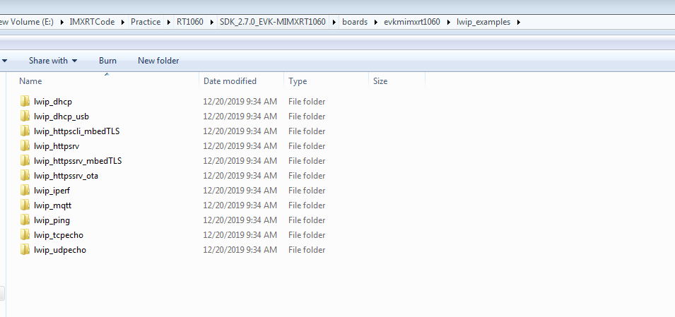

   Which detail lwip sample code you are using, from SDK side for MIMXRT1060?
Which project you are using?
Could you tell me the detail steps to reproduce your issues?

Thanks a lot for your reply. I used lwip_tcpecho example without changes except IP address.
The scenario are:
  1. Run tcpecho example
  2. Connect to the tcp server using Putty (ip: 192.168.3.102, port: 7)
  3. Press any keys on Putty to check it works.
  4. Unplug an Ethernet cable.
  5. A following network error occurred and the connection was closed once I unplug the cable.

 To be honest, I think, when the Ethernet cable is disconnected, the windows report the connection issue, it should be normal, do you want when the cable is disconnected, then the windows tool have nothing notification?
