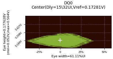

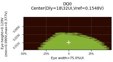

hermann_ruckerb
i have to admit, that I only do the Measurement .. not the config,
Usually i work with controllers that do the Training on their own... it looks like for i.MX93 i need to do the characterization and then set the config manually ??? (i thought this was the process for i.MX6 and since that time nxp added an automated training ...)
But looking to the vTSA results for write this does not look like a result that i would trust:Write_vTSA_DQ0.jpg
so this resutls would indicate to set Vref to 0.1548mV and I would need to set this manually in the Code?
but as the lower level seems to be way to high (79mV) in order to get a reasonable eye the proposed vref seems way too hight.
for read it looks more reasonable:
I use the imx93-evk eval board and pre-configuration in my setup, so i expected all settings correct and i did not change these.
But based on these results i would expect i need to adjust the configuration for the settings for this board?
Sorry for this stupid question:
So my assumption is, that i need to go into the Registers tab, find e. g.the Register for SoC drive strength, DRAM termination, modify this, download this and re-do the vTSA to find the result for the new setting, then modify Vref to the reported value from vTSA and enter this in the Registers tab again.
Is this the expected process?
I was looking to find SoC drivestrength register in the RefManual but was not successful .. can you tell me this register? (I hope this register would help to find also the other registers that I am missing )
 Maybe the better way would be to set a different lower limit in the vTSA in order to get a full eye, not jsut the upper half end then get a better result ...
Thanks for any feedback, and sorry again for my stupid questions..
Hermann

JorgeCas
It looks like for i.MX93 i need to do the characterization and then set the config manually ?
No, I think I was not clear.
Usually, MR contents are defined on ddr_config.ds file according to your DDR configuration. The board will perform a calibration and MR content will not change after calibration. You could try to test it to see changes if any.
But based on these results I would expect I need to adjust the configuration for the settings for this board?
No, I think not, because these are the tested settings.
I suggest you enter your DDR configuration to create the initialization scripts and could do a modification if needed.
