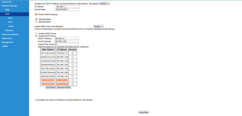

Hi Community,
I am using the Ubuntu based Desktop (BSP 5.10.72-2.2.0) on iMX8M Plus, but the IP addresses that the Ethernet interfaces obtain are weird :

Meanwhile, the gateway/router only attributes 192.168.1.x.
Does anyone observe same issue ?

Hello khang,
For some reason it's getting that ip, do the hardware connector is connected to another network? it is weird if you have not connected to internet.

Hi @Bio_TICFSL ,
With the same Ethernet connection, my laptop has valid LAN address.
I also configured so that the router attributed a static IP addresses for the MACs of iMX8MP-EVK, but it still got weird IP addresses :
Meanwhile, it worked well when I connected the EVK into my laptop with DHCP server installed, expected IP address was attributed.
