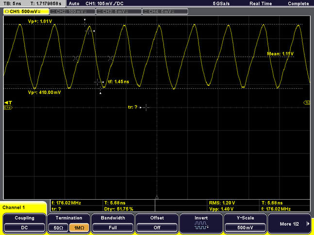

Hi.
There's a question about, SDIO_CLK signal.
Now, I checked at i.MX 7ULP's SDIO_CLK line and saw that the shape of waveform is "Sin".
I want to ask you is this, is it correct that shape of waveform is "sin"?
> I used "SDR104" mode, and checked it.
> I though shape of SDIO_CLK's waveform should be, "pulse", but it was "Sin", so I wonder this is the correct shape.
Is it correct shape?
> i.MX Processor do generate waveform of SDIO_CLK signal as "Sin"?
Regards.
Have a nice day.
TAEHYEOK.

jimmychan
The waveform is no problem.
