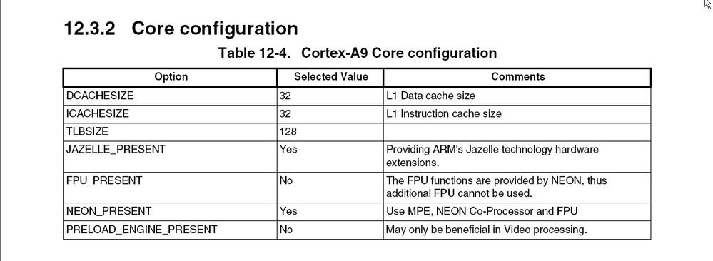

Hi Richard
fpu is not implemented on i.MX6 platform, below part of i.MX6DQ RM
for flags one can look at attached gcc release note.
