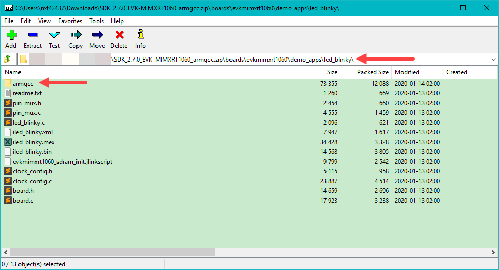

mkellner
As well, I am looking to build with gcc.
I have found Section 5 of the document but it refers to directories in example code that don't exist.
slate:hello_world $ pwd
/Users/user/Downloads/nxp/SDK_2.7.0_EVK-MIMXRT1060/boards/evkmimxrt1060/demo_apps/hello_world@
slate:hello_world $ ls
board.c          hello_world.c    board.h        hello_world.mex
clock_config.c   hello_world.xml  clock_config.h pin_mux.c evkmimxrt1060_sdram_init.jlinkscript pin_mux.h   hello_world.bin
readme.txt
The docs refer to an armgcc directory, which I expect holds a makefile, maybe a linker map. But I don't see the armgcc directory here.
3,643 Views
victorjimenez
Hi Michael,
The armgcc folder is located within each SDK project, see the image below.
You can download the SDK from the following link: Welcome | MCUXpresso SDK Builder. Additional to this, you need to keep in mind the following note mentioned on the Getting Started with MCUXpresso SDK for EVK-MIMXRT1060 pdf, "The OpenSDA interface on your board is programmed with the J-Link OpenSDA firmware. If your board does not support OpenSDA, then a standalone J-Link pod is required.". The on-board debugger of the RT1060-EVK doesn't support the JLink firmware so you need a standalone JLink debugger.

mkellner
Thank you. I realize I had chosen the wrong options when downloading the SDK.
