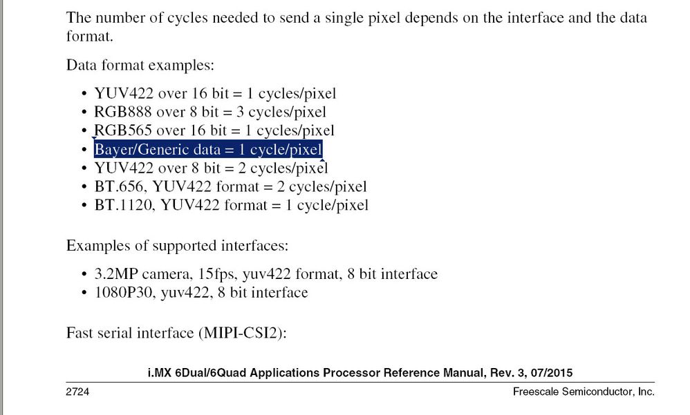

I have a question about number of cycles needed to send a single pixel.
According to RM Rev3.0, there are following description.
How about RAW Bayer 12bit ?
Is it need 2 cyles/pixel ?

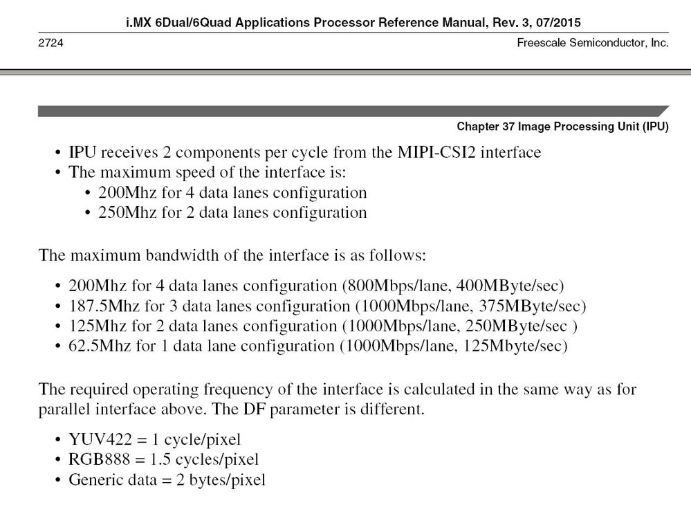

Thank you for reply but please let me confirm again.
According to the P2724 of RM Rev 3.0, there is a following description.
Bayer/Generic data = 1 cycle/pixel
However, in P2725 of RM Rev 3.0, there is a following description
Generic data = 2 cycle/pixel
Both of above description, I guess there have different parameters.
Could you check again ?

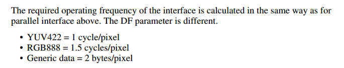

igorpadykov
Hi Ko-hey
according to RM for MIPI 1 cycle/pixel is for YUV422
2 cycle/pixel is for RAW (generic) format
igor

This is final confirm.
The following is the my understanding.
Is it correct ?
In parallel interface, Generic data needs 1 cycle/pixel
In MIPI-CIS2 interface, Generic data needs 2 cycle/pixel
I'm sorry for asking you many times.
But the cycle is very important for me.
Ko-hey
1,455 Views
igorpadykov
Hi Ko-hey
yes this is right.
igor
