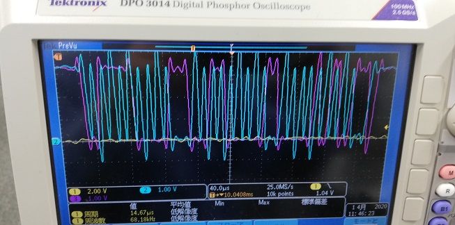

I am making a program that uses MINISASTOCSI (OV5640) and cortex-M4 to communicate by I2C with iMX8MminiEVK.
However, I cannot confirm the response from the I2C camera.
The I2C driver uses MCUexpressoSDK (SDK_2.7.0).
When I use an oscilloscope to look at the I2C SDA and SCL lines, I have confirmed that the OV5640 does not respond with an ACK to the I2C slave ID but becomes a NACK.
Slave address is set to 0x3c.
"PWDN" and "RESETB" of OV5640 are controlled by referring to "ov5640_probe" of "ov5640_v2.c" of "i.MX Linux Rev. L4.19.35_1.1.0, 11/2019".
Is there anything else to be aware of?

t-sugiyama
Hello igor,
Thank you for taking the consultation.
I confirmed that a normal I2C signal was output when the "OV5640" was connected by operating "i.MX8MminiEVK" with "i.MX Linux Rev. L4.19.35_1.1.0, 11/2019" .
The attached file is the first I2C signal that “i.MX Linux” outputs to “OV5640”.
I don't think there is a hardware problem.
I anticipate that the way I am currently challenged lacks the conditions to launch the OV5640.
Tetsuya
