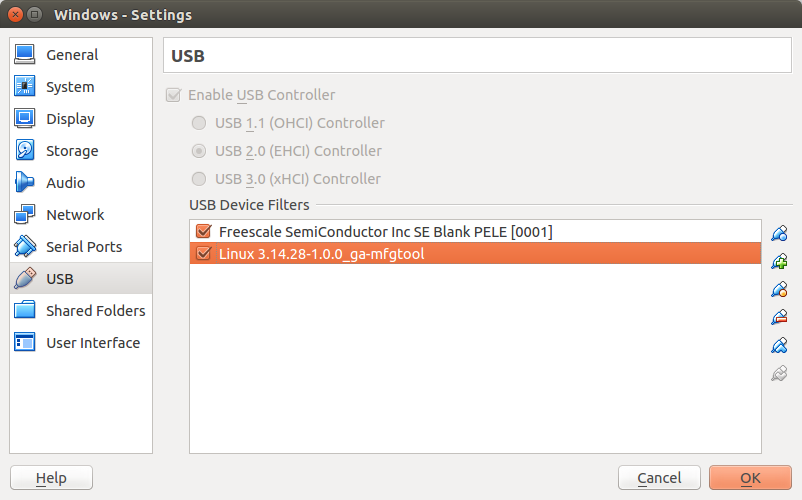

You can configure USB filters to automatically connect the USB devices to the windows VM as you can see in this screenshot.virtualbox_usb_filters.png
This way the manufacturing tool works from a VM, but it is much slower then a native windows. It takes multiple minutes to upload the u-boot and initramfs. Do you have this experience as well?

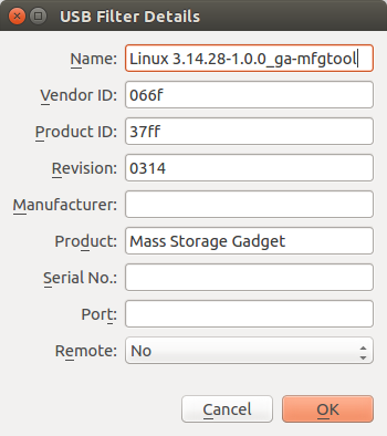

The second line in the filter screenshot is for the device in USB mass storage mode, after the uploaded kernel has booted. I used the "Add new USB filter.." button to get this. Here is a screenshot of my settings.
