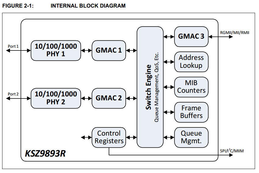

KSZ9893 is a 3 port ethernet switch; port 1 and 2 incorporate 10/100/1000 Mbps PHYs. Port 3 has interfaces that can be configured as RGMII, MII or RMII. Port 3 is connected directly to iMX8mq.
Because Port 3 does not have PHY, so I think cannot treat it as an ethernet tranciver (eg. AR8031 in imx8mq-evk). I do some modify in kernel device tree but it still not working; cannot obtain IP address too.

There is 125 MHz on both TX Clock and RX Clock; Already measured by oscilloscope. It still cannot obtain IP address.
If anyone who has experience on ethernet switch, please help. My kernel version is 4.9.123.

Not yet, but try this
imx8mq <-> LAN9500<->KSZ9893, it is posible. Let TX_ER and RX_ER be floating. And Port 2 connected to Internet.
