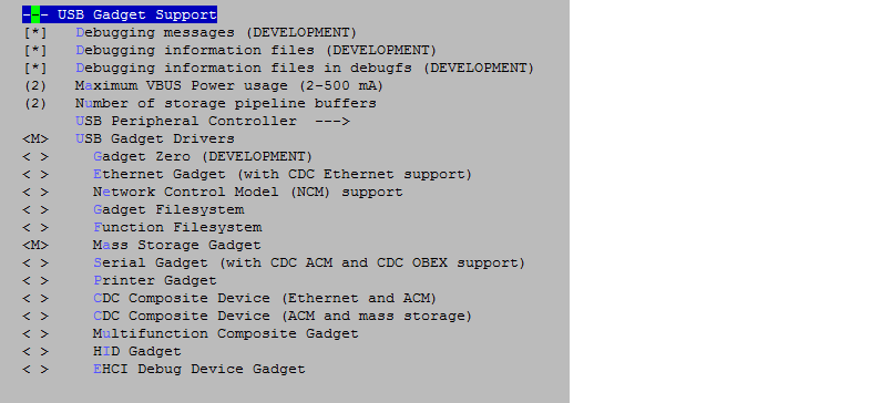

Hello there Greetings.
Kernel:3.10.9
Board: i.MX6  Solo based  custom board.
Step 1: load the mass storage driver
insmod g_mass_storage.ko file=/dev/mtdblock5
calling  msg_init+0x0/0x1c [g_mass_storage] @ 381
initcall msg_init+0x0/0x1c [g_mass_storage] returned -19 after 1549 usecs
insmod: can't insert 'g_mass_storage.ko': No such device
Step 2: dmesg
calling  msg_init+0x0/0x1c [g_mass_storage] @ 388
couldn't find an available UDC
initcall msg_init+0x0/0x1c [g_mass_storage] returned -19 after 1606 usecs
calling  msg_init+0x0/0x1c [g_mass_storage] @ 389
initcall msg_init+0x0/0x1c [g_mass_storage] returned -19 after 1570 usecs
I am stuck with this error. Appreciate any pointers ...
Krishnan.

Dear Eric,
Thanks for the suggestions. It was a problem with UDC controller driver.  I have enabled chip idea hdr controller  driver in kernel
Now the  g_mass_storage works fine

It looks like I have some  problem in VBUS configuration. Th USB_OTG_ID pad was left unconnected on the board.
In the dts file i have added below code to enable OTG support.
&usbotg {
        vbus-supply = <&reg_usb_otg_vbus>;
        pinctrl-names = "default";
        pinctrl-0 = <&pinctrl_usbotg_1>;
        disable-over-current;
        status = "okay";
One more experiment done was compiling g_mass_storage driver statically. But at this time I am not able  change the file paramter.
In kernel configuration i have selected below options.
under USB Peripheral Controller
<*> Freescale Highspeed USB DR Peripheral Controller
I have added some debug prints in drivers/usb/gadget/udc-core.c where the probe is happening. It says probe could not find USB device controller driver.
I am  little lost  how to proceed. Any pointers/help will be much appreciated.
Thanks in advance
Krishnan

EricNelson
Senior Contributor II
Hi Krishnan,
This may be an issue with the pad configurations for Solo.
We didn't have support for Dual-Lite/Solo in our 3.10.9 release, but USB OTG was supported on i.MX6Q:
     http://boundarydevices.com/imx6-linux-kernel-3-10-9/
We have recently tested on 3.10.17, notably on our Nitrogen6_Lite board:
     http://boundarydevices.com/mx6-linux-kernel-3-10-17-beta/
You can compare your configuration against nit6xlite_defconfig and your DTS files against
imx6dl-nit6xlite.dts in in this tree:
     linux-imx6/arch/arm/boot/dts at boundary-imx_3.10.17_1.0.0_beta · boundarydevices/linux-imx6 · GitHu...
We tested using g_ether, not g_mass_storage, but the detection and registration
should be the same.

marcomadrigal
You can not load two gadget drivers simultaneously, for this you need to load them as a composite driver, you can do this through configfs or hardcoded on the legacy drivers.
-Marco
