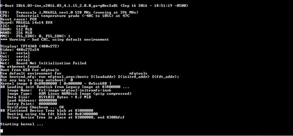

I am trying to write binaries to custom imx6ull  board's nand flash using MfgTool.
By doing slight modifications in ucl2.xml file I could able to load default uboot, zImage, dtb and rootfs available in MfgTool into nand flash. And by changing boot configuration pin settings, I could able to boot successfully.
Everything works fine with default binaries available from MfgTool package downloaded from NXP website(i.e L4.1.15_2.0.0-ga_mfg-tools)
I have only issue in writing custom zImage and dtb files to nand flash.
I am trying in 3 different scenarios, given the details below.
In all the scenarios I am not changing u-boot file(trying to use the default file available from MfgTool)
Scenario 1: Replacing zImage provided in MfgTools package with custom zImage built using latest BSP 4.14.
When I am trying to load custom zImage file by replacing zImage in MfgTool, writing to NAND is not happening.
I could see following message from console hanging without any further proceeding.
Below screenshot captured when I replace the zImage by custom zImage alone.
Uboot, dtb files not changed, used the default MfgTool provided itself.

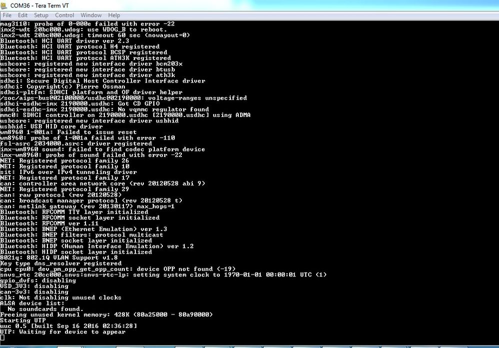

Scenario 2: Replacing dtb provided in MfgTools package with custom dtb built using latest BSP 4.14.
When I replace zImage-imx6ull-14x14-evk-gpmi-weim.dtb file alone with custom dtb file, console showing following message and hanging without any further proceeding.
Below screenshot captured when I replace with custom dtb file alone. Uboot, zImage not changed, used the default MfgTool provided itself.
Scenario 3: Replacing dtb and zImage files provided in MfgTools package with custom dtb and zImage files built for latest BSP 4.14.
Getting same behavior as Scenario 1.

Rita_Wang
Have you tried to download all images you build for your customer board use the mfgtool? The mfgtool download process is following the uxl2.xml file.
