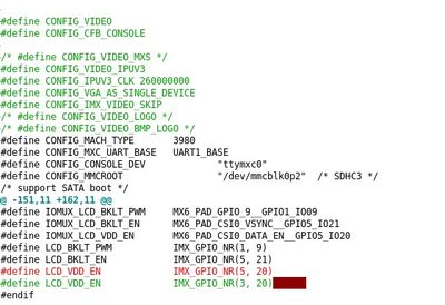

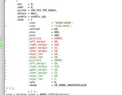

My LCD parameters are configured as below.
in mx6adva_common.h
 and mx6adva.c
 I has switched a normal u-boot_crc.bin over my uboot file, the normal uboot bin file can start and display normally. I think there must be some incorrect configuration existed becuase I use same zImage file and dtb.

Zhiming_Liu
Please check your timing in struct display_info_t

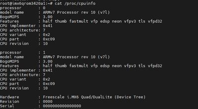

    Finally, I can display image normally.  However, the color palette when configured as RGB24 is very poor, even more limited than the 16-color palette of the development board.
My product board and cpuInfo.
My development board and its cpuInfo .
They are using same LCD displayer, same QT environment version and same application. I doubt there must be some parameters which hasn't been noticed yet that hasn't been configure well. More bootup detail log please check attached file out.

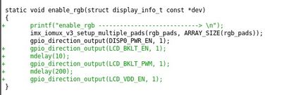

uboot update code
