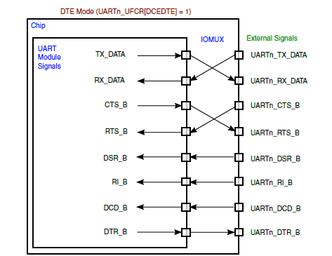

I use CSI0_DAT14 and CSI0_DAT15 for UART5 ,  on default , CSI0_DAT14 = UART5_RX  and CSI0_DAT15 = UART5_TX, But I want to swap them, so in my dts file i change as following:
pinctrl_uart5_1: uart5grp-1 {
fsl,pins = <
MX6QDL_PAD_CSI0_DAT14__UART5_TX_DATA 0x1b0b1
MX6QDL_PAD_CSI0_DAT15__UART5_RX_DATA 0x1b0b1
But it doesn't work. Can you give a hint for the solution.

BiyongSUN
Please refer to  imx6ull-14x14-evk.dts
all the i.MX6 family use the same mechanism.
1. configure the IOMUX to swap the pin.
2. tell uart module  DTE or DCE mode.
please check the reference manual
690 &uart2 {
691         pinctrl-names = "default";
692         pinctrl-0 = <&pinctrl_uart2>;
693         fsl,uart-has-rtscts;
694         /* for DTE mode, add below change */
695         /* fsl,dte-mode; */
696         /* pinctrl-0 = <&pinctrl_uart2dte>; */
697         status = "okay";
698 };

BiyongSUN
I did not see your dts tell i.MX6 it is DTE by the keyword fsl,dte-mode; which is in the binding guide.
It is very easy, just swap pin, tell the i.MX6 DCE or DTE mode as previous reply.
In you case,
DCE
pinctrl_uart5: uart5grp {
fsl,pins = <
MX6QDL_PAD_CSI0_DAT14__UART5_TX_DATA 0X13059
MX6QDL_PAD_CSI0_DAT15__UART5_RX_DATA 0X13059
690 &uart5 {
692         pinctrl-0 = <&pinctrl_uart5>;
698 };
DTE:
pinctrl_uart5dte: uart5dtegrp {
fsl,pins = <
MX6QDL_PAD_CSI0_DAT14__UART5_RX_DATA 0X13059
MX6QDL_PAD_CSI0_DAT15__UART5_TX_DATA 0X13059
&uart5 {
         pinctrl-0 = <&pinctrl_uart5dte>;
          fsl,dte-mode;
        status = "okay";

angelo_d
Senior Contributor I
This is an old thread and helped a lot to finally clarify things.
Only one note. Picture with straight connections should be named DTE. Becouse internally cross-wired TX - > RX is tipical of a DCE device (modem) that received signals on TX.  Please correct me if i am wrong, it's just to clarify.
2,826 Views
BiyongSUN
understand your point. But it is i.MX6 special pin name and requirement. we ask designer follow the i.MX6 pin name. The same is for the ethernet connections. i.MX6 asks TX connect to TX phy side.  For the uart case, TX to TX the fifo inside the chip, which is not shown here in the diagram,  is RX to TX. For swap,  the IOMUX does the first swap for TX/RX, which need daisy iomux help and the "fsl,dte" is the second swap by the internal fifo.   I totally agree with you in the protocol layer. TX to RX is DCE.  TX to TX is DTE. But we need to follow the chip design and the BSP, right?
2,826 Views
angelo_d
Hi Biyong,
thanks for pointing out the reasons. This thread is really good, pictures here above clear any doubt and helps a lot.
So, if i understand properly, you have finally a dual swap. So if so, all is clear now.
Old guys knows that DTE to DTE requires a null-modem (swapped) cable, and DTE to DCE a straight one.
But for the current case, DTE and DCE are just names, and at the end is not even importand who is who. It's likely more important proper connection.
angelo
