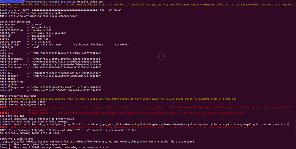

1)  I copied the kernel and uboot code from the following two locations and made my own code changes.I wanted to know how to put the changed code into the yocto environment and then use the bitbake command to generate the file system and other required files accordingly.My server computer is not connected to the Internet
/opt/yocto/fsl-release-bsp/build/tmp/work/imx6qsabresd-poky-linux-gnueabi/linux-imx/4.1.15-r0/git
/opt/yocto/fsl-release-bsp/build/tmp/work/imx6qsabresd-poky-linux-gnueabi/u-boot-imx/2016.03-r0/git
2)I want to recompile the kernel file, and after executing the following two statements, I am prompted with the following error.
bitbake -c cleansstate linux-imx
bitbake linux-imx
3)  Please let me know if there is any reference technical document about using yocto to modify uboot,kernel and build your own single board.

Hi zh_y,
You need to create patch for the changes you made and place them in yocto build system. Please follow below document for the same.
i.MX Yocto Project: How can I patch the kernel?
