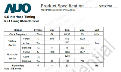

Dear TI ,
HW: srg-imx8mplus (Base on : imx8mplus)
kernel version: 5.10.72
I can't measure the LVDS0_CLK_N signal , but I can  measure the VDD_LVDS 3.3V .
Please refer to the imx8mp_LVDS.log. Please help fix this issue .

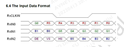

lvds-channel@0 {
fsl,data-mapping = "spwg";
fsl,data-width = <18>;
status = "okay";

LCM data sheet :
srg-imx8mplus HW : LVDS
2,491 Views
t2865k5
Dear NXP ,
I can measure the LVDS0_CLK_N signal . It is 74.25MHz but it not 68.93MHz.

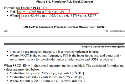

Hi @t2865k5
You need add new pll=965020000 in imx_pll1443x_tbl
/drivers/clk/imx/clk-pll14xx.c
static const struct imx_pll14xx_rate_table imx_pll1443x_tbl[] = {
PLL_1443X_RATE(1039500000U, 173, 2, 1, 16384),
PLL_1443X_RATE(650000000U, 325, 3, 2, 0),
PLL_1443X_RATE(594000000U, 198, 2, 2, 0),
PLL_1443X_RATE(519750000U, 173, 2, 2, 16384),
PLL_1443X_RATE(393216000U, 262, 2, 3, 9437),
PLL_1443X_RATE(361267200U, 361, 3, 3, 17511),
The pmks should calculated from below formula

mengfei
你好我按照你们的文档修改了以下内容,可见我添加了三个pll属性,其中56Mhz的参数是你们给的,65Mhz及32Mhz的参数是我自己计算的,但是下面修改的项只有你们给的56Mhz,和我自己修改的32Mhz的成功了,我自己改的另外一个65Mhz的却失败了,我又检查了下设置两种属性的参数都是满足你们的文档要求的,不知道为什么设定为65Mhz的代码,在编译并重新写入内核后示波器测量的clk仍是74.25Mhz.请帮忙看下:

+ PLL_1443X_RATE( FOUT, _m,_p, _s, _k)
+ 计算公式为:FOUT=((m + k/65536) × FIN) / (p × 2^s)
+ 之所以最终设定的值与上述计算结果不同是因为计算公式找不到恰当的组合
