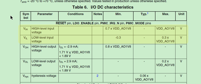

Hi @Dave_SU ,
  About the pin logic leave, you can find it from the datasheet:
  Do you test this SDK code for the SW input:
SDK_2_11_1_EVK-MIMXRT595\boards\evkmimxrt595\driver_examples\gpio\led_output
  This should works.
   About your mentioned led output, then read it for the input, you need to check the pin level from the hardware, whether it meet the H level voltage: >0.7vdd, maybe due to the HW, the level didn't match it, you can control one pin which didn't connect to a lot of circuit, that will be more easy to test.
