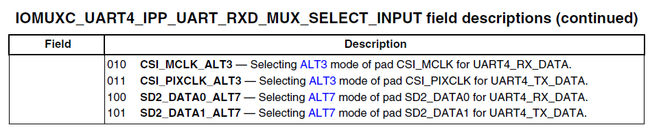

jimmychan
please check your daisy chain setting for the UART_RXD_MUX_SELECT_INPUT
975 Views
m4l490n
Contributor V
Thanks jimmychan​ for helping.
But that is only for the Rx pin right, I mean, I still would have to see something in my terminal because Tx is configured correctly. Please help me, this is being a nightmare, I just can't make it work :smileysad:. I've been on this for two weeks now and I'm starting to pull my hair out in despair.
Thank you for your time.
