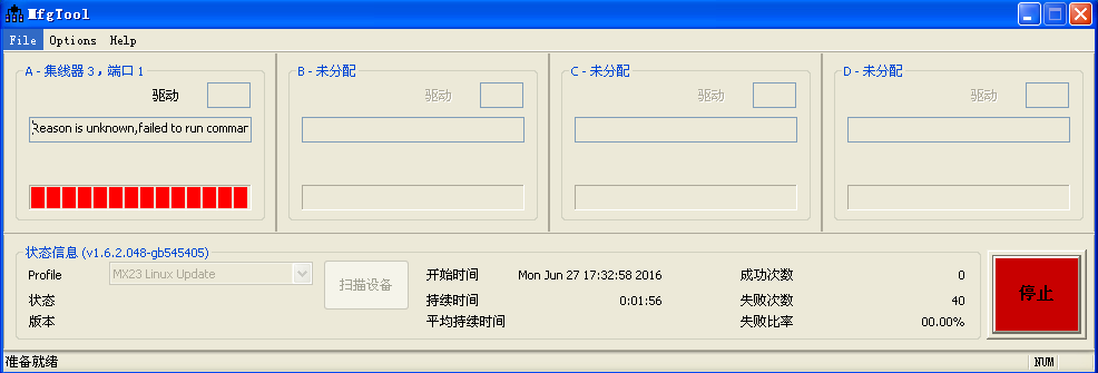

I made a mistake with USB connection ,i had correct it,now i have an another question about download image by mfgtool,mfgtool showes me that runtime error in the picture , can you help me? QQ图片20160627170939.png

I download new version mfgtool  ,it shows me like picture below.

stevenshan
There is no external FALSH and SDRAM in my board,is it will effect that?
1,316 Views
art
You have to adapt the MFGTool to your particular hardware, refer to the software documentation for the information on how to do this.

stevenshan
Hi Artur
my circuit is designed by imx233 evk,sdram MT46V32M16P i use is the same with evk ,but the flash is K9F2G08U0C not K9LBG08U0D wich is use in evk, so i need to make my own firmware image ?
1,316 Views
stevenshan
additional:
I only use one sdram MT46V32M16P,but evk use two.
1,316 Views
art
Yes, you have to adapt your firmware to your particular hardware configuration, e.g. amount of memory etc.
