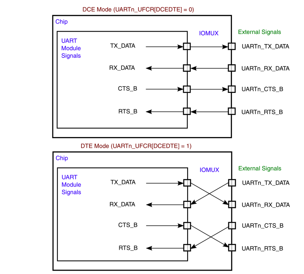

For UART DMA hardware flow control (CTS\RTS additional wires) should be applied.
