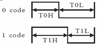

HankChang989
Thank you Snaket Parekh for the prompt response.
1.What is the bit width of the Parallel bus address and data? (Are both the address and data 32-bit?)
2.Is there any sample code available for reference?
3.I want to control the timing of 0 and 1 for data bit, is it possible?

Sanket_Parekh
Hello @HankChang989 ,
I hope you are doing well.
1. What is the bit width of the Parallel bus address and data? (Are both the address and data 32-bit?)
->It is not fixed because the programmable Data port sizes for each Chip Select are x8, x16, and x32.
->There is Independent synchronous Memory Burst Read Mode support for NOR-Flash and PSRAM memories like x16 and x32 port size.
About this one can refer to SRAM.
->EIM gives support for multiplexed address/data bus operation x16 and x32 port sizes.
2. Is there any sample code available for reference?
3. I want to control the timing of 0 and 1 for the data bit, is it possible?
->Please kindly share the details about these queries.
