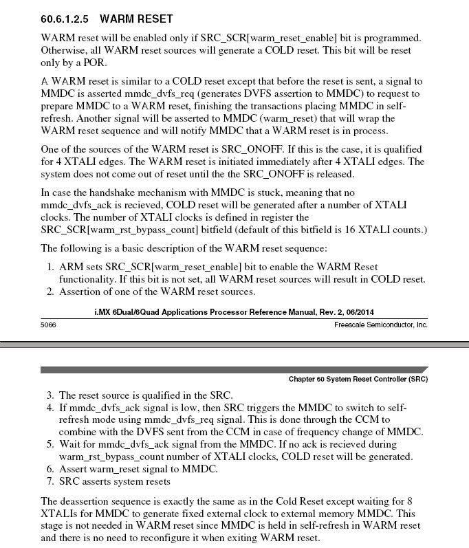

Hi all I can't understand between cold and warm reset. In reference manual P5062, there is a table that is shown SRC reset functionality. However, there are no difference between cold and warm reset. http://cache.freescale.com/files/32bit/doc/ref_manual/IMX6DQRM.pdf What is the difference between cold and warm reset? Best Regards,

Hi ko-hey
difference is dscribed in sect.60.6.1.2.4 COLD RESET
60.6.1.2.5 WARM RESET IMX6DQRM
Probably main difference is that during warm reset MMDC
can put DDR in self refresh.
igor

Hi Igor
Thank you for your replay.
However, it's not about sequence. I want to know about functionally difference.
Here is my understandings. Are these correct?
  • POR will erase all data including each register value
  • COLD reset will erase all data except each register value
  • WARM reset will do self-refresh to DDR

Hi ko-hey
I am not sure that such complex subject may be explained
in such simple manner. Please look carefully documentation
in particular Table 60-4. SRC reset functionality IMX6DQRM
~igor

Hi Igor
I apologized it. I think it is just as you say.
So let me talk about Table 60-4.
In Table 60-4, it looks no functionally difference between COLD and WARM reset.
What's the difference between COLD and WARM reset?
Is the main difference only self refresh?

Igor
I understood that WARM reset is similar to CLOD reset except to MMDC.
