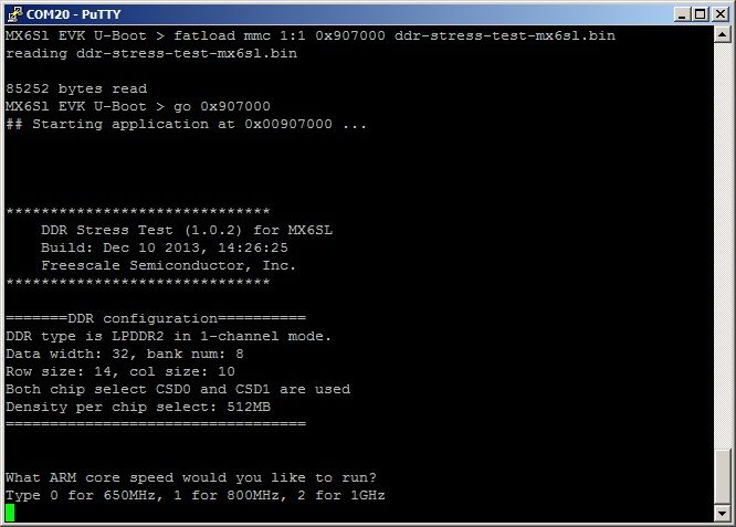

The commands to run ddr test in i.MX6Q uboot:
U-Boot > fatload mmc 2:1 0x907000 ddr-stress-test-mx6dq.bin
U-Boot > go 0x907000

Hi Grace! How are you? I use the bin files from "DDR_Stress_Tester_V1.0.1_UART1_for_SDboot&JTAG.zip", but the program hangs when it calibrates the memory. I'm using Freescale Sabre SD board.
MX6Q SABRESD U-Boot > go 0x907000
## Starting application at 0x00907000 ...
    DDR Stress Test (1.0.2) for MX6DQ
    Build: Dec 10 2013, 14:26:05
    Freescale Semiconductor, Inc.
=======DDR configuration==========
BOOT_CFG3[5-4]: 0x00, Single DDR channel.
DDR type is DDR3
Data width: 64, bank num: 8
Row size: 14, col size: 10
Chip select CSD0 is used
Density per chip select: 1024MB
What ARM core speed would you like to run?
Type 0 for 650MHz, 1 for 800MHz, 2 for 1GHz, 3 for 1.2GHz
  ARM set to 800MHz
Please select the DDR density per chip select (in bytes) on the board
Type 0 for 2GB; 1 for 1GB; 2 for 512MB; 3 for 256MB; 4 for 128MB; 5 for 64MB; 6 for 32MB
For maximum supported density (4GB), we can only access up to 3.75GB.  Type 9 to select this
  DDR density selected (MB): 1024
Calibration will run at DDR frequency 528MHz. Type 'y' to continue.
If you want to run at other DDR frequency. Type 'n'
