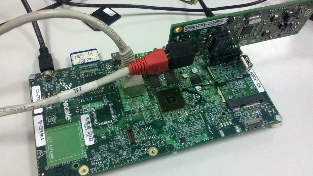

HW:

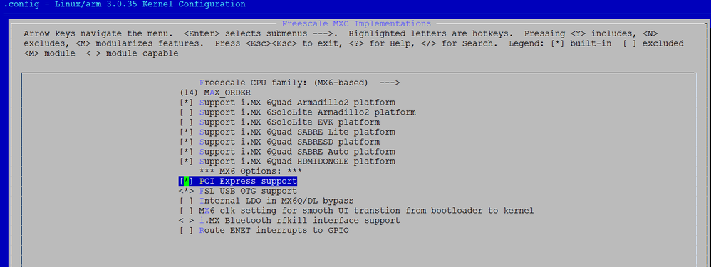

one i.MX6Q SD boards, and one INTEL pciex1 1000M CT network card.
SW(The images used by me are attached):
* Apply the attached patches(kernel and uboot) to the kernel/uboot source codes, re-build, get the images.
Kernel is based on imx_3.0.35_4.0 release, uboot , is based on imx_v2009.08

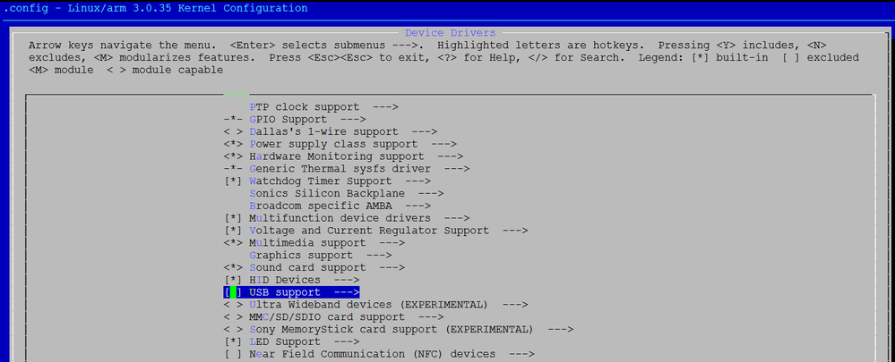

# build out SD/MMC and USB driver to make DRAM hibernate work
# build pcie in.
