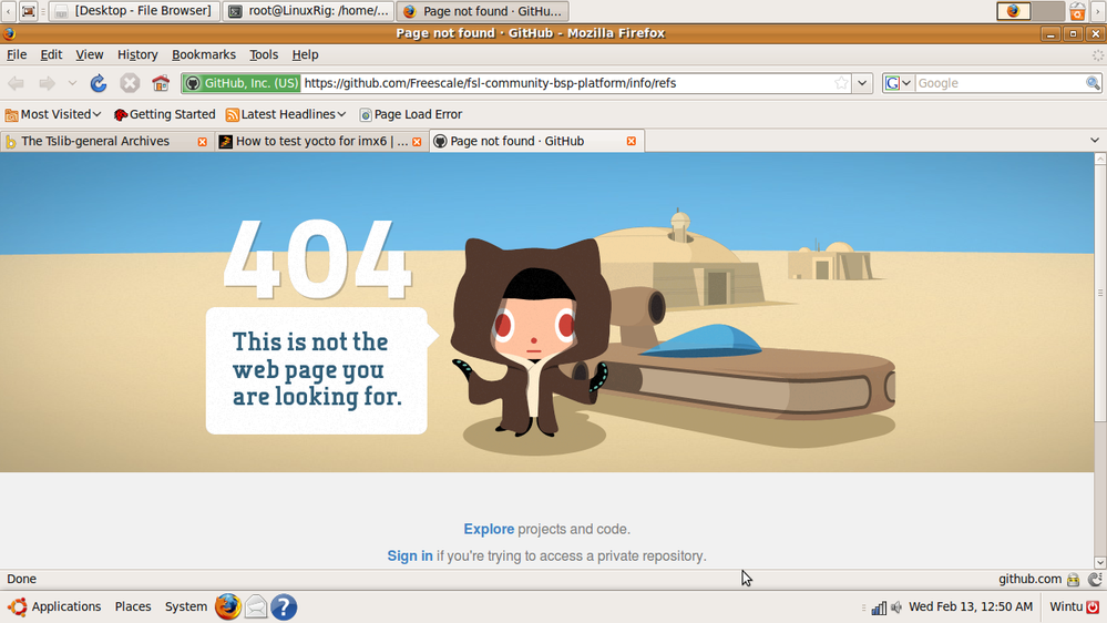

Hi.... I am running into this basic error.. Looks like repo cannot find the web page.
root@LinuxRig:/home/wintu/YOCTO# repo init -u http://github.com/Freescale/fsl-community-bsp-platform -b danny
... A new repo command ( 1.18) is available.
... You should upgrade soon:
    cp /home/wintu/YOCTO/.repo/repo/repo /bin/repo
fatal: http://github.com/Freescale/fsl-community-bsp-platform/info/refs download error - The requested URL returned error: 403
  Any help....
I just tried it over here and it does work.
Could you, please, test the same again? If you face the error again, try to reach the web page using your browser.
Make sure your proxy allow this operation. (double check if you´re using http or https proxy)
Besides the tests Daiane has asked you please give more details about your host system:
* distribution
* version
Hi Daiane,
    I tried same thing again.. Even i tried with https:// and still same issue.
And when i try it from browser too i get same mesage. ( attached screen shot)
I'm from india... So is that web page not accessible from india ??
Winston
Hi OtavioSalvador,
      I m using Ubuntu 9.04 Jaunty. with kernel 2.6.28-11-generic.
  I guess that web address not accessible in india.
  Winston
I just did a new test here:
~/test% repo init -u https://github.com/Freescale/fsl-community-bsp-platform -b danny
Get https://gerrit.googlesource.com/git-repo/clone.bundle
Get https://github.com/Freescale/fsl-community-bsp-platform
  % Total    % Received % Xferd  Average Speed   Time    Time     Time  Current
                                 Dload  Upload   Total   Spent    Left  Speed
  0     0    0     0    0     0      0      0 --:--:--  0:00:09 --:--:--     0
curl: (22) The requested URL returned error: 404 Not Found
Server does not provide clone.bundle; ignoring.
WARNING: gnome-keyring:: couldn't connect to: /run/user/otavio/keyring-q0sd1e/pkcs11: No such file or directory
remote: Counting objects: 69, done.
remote: Compressing objects: 100% (63/63), done.
remote: Total 69 (delta 21), reused 53 (delta 5)
Unpacking objects: 100% (69/69), done.
From https://github.com/Freescale/fsl-community-bsp-platform
* [new branch]      danny      -> origin/danny
* [new branch]      denzil     -> origin/denzil
* [new branch]      master     -> origin/master
* [new tag]         1.2        -> 1.2
Your identity is: Otavio Salvador <otavio@ossystems.com.br>
If you want to change this, please re-run 'repo init' with --config-name
repo initialized in /home/otavio/test
So it is clearly something at your side. I once had a problem due curl issues. 'repo' uses curl to fetch some stuff (as git does as well) so maybe you might try to upgrade curl and give it a new try?

Sorry, but also i trivial problem, probably:
$ repo init -u https://github.com/Freescale/fsl-community-bsp-platform -b danny
...but nothing is fetched. The repo init commands just outputs the line and exits.
So...:
$ repo sync
error: command 'sync' requires repo to be installed first.
        Use "repo init" to install it here.
Same result id http:// is used instead of https:// - in the command, as well as in the REPO_URL inside the repo script.
Sorry I'm no git expert - is there supposed to be a file named "clone.bundle" in the referenced git-repo? I don't see it...
I´m downloading it over here.
Could you, please, try again?
Same result.
But in the meantime I tried at home, on my own computer and network: No problem (or not this problem, at least :smileyhappy:).
So the problem is definitely in "my" end. Differences: At work, with the problem, we have CentOS5 + addons, and firewall/proxy. At home: CentOS6 and no proxy. (Needed to install a newer git than the one provided with CentOS6).
Think I tried everything to get the proxy stuff correct; I *was* able to fetch "repo" with curl over https. And also tried git config.... I will investigate further; guess it's hard to figure out from your place what's wrong here!
The build at home ran for most of the night, then bailed out... I'll raise that as a separate question.
And... tnx for you prompt answer!

"File not found", it seems... does the recipe need update - or other suggestions?
Seems to be a proxy problem in connection with the "repo" script.
Hacked the script; the clone.bundle file is created with the content: <HTML></HTML>
clone.bundle is created by the _DownloadBundle function in "repo". It uses urllib to retrieve the data.
With wireshark I can see that the proxy server is accessed with "GET https://gerrit.googlesource.com./(...)", but there is no encrypted session started.
Maybe bad Python version? (It's 2.6).
