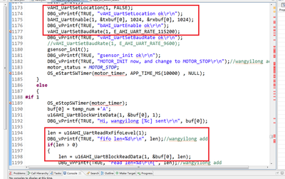

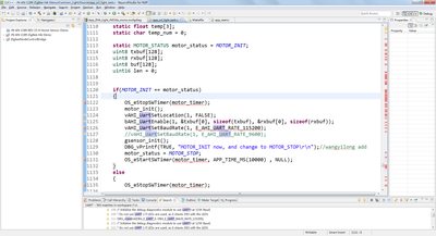

YeelongWong
Hi,@mario_castaneda
Tks for reply!
Yes, I connect a G-sensor to JN5169 UART 1.
The G-sensor will pour a lot of UART data to JN5169.
Above is the hardware.
The software is like this:
The base code is JN-AN-1189-ZigBee-HA-Demo with JN-AN-1189-ZigBee-HA-Demo-1v15.pdf.
I add one timer-triggered task in the App_ZHA_Light_JN516x_mono.oscfgdiag.
And add code in JN-AN-1189-ZigBee-HA-Demo\Common_Light\Source\app_zcl_light_task.c
 init part and work part, but JN5169 resets:(
I think when data flood comes, the DMA will overflow and discard the data, why it will exceed the bounties of the buffer??

Hello, @mario_castaneda
I have updated news:
I confirmed my code about reading from UART1, and I thought it was right, because when I used low speed data rate at 115200 bps, JN5169 UART1 could receive data and print out.
The key point is the other UART node, when the other node sends data with high  speed at 115200 bps, JN5169 will report "Bus error" or "AlignmentException" and then reset.
The JN5169 datasheet says the UART data speed supports 4Mbps.
But when I pour data via UART1, the JN5169 resets.
So if there bugs with UART 1 of JN5169?
Tks a lot!

YeelongWong
Hi, Mario
I init and use UART 1 like this:
Then in the following code, I read the data with these two APIs:
 len = u16AHI_UartReadRxFifoLevel(1);
if(len > 0)
len = u16AHI_UartBlockReadData(1, &buf[0], sizeof(buf));
The bus error will not occurs every time, not 100%. So it is so strange.
