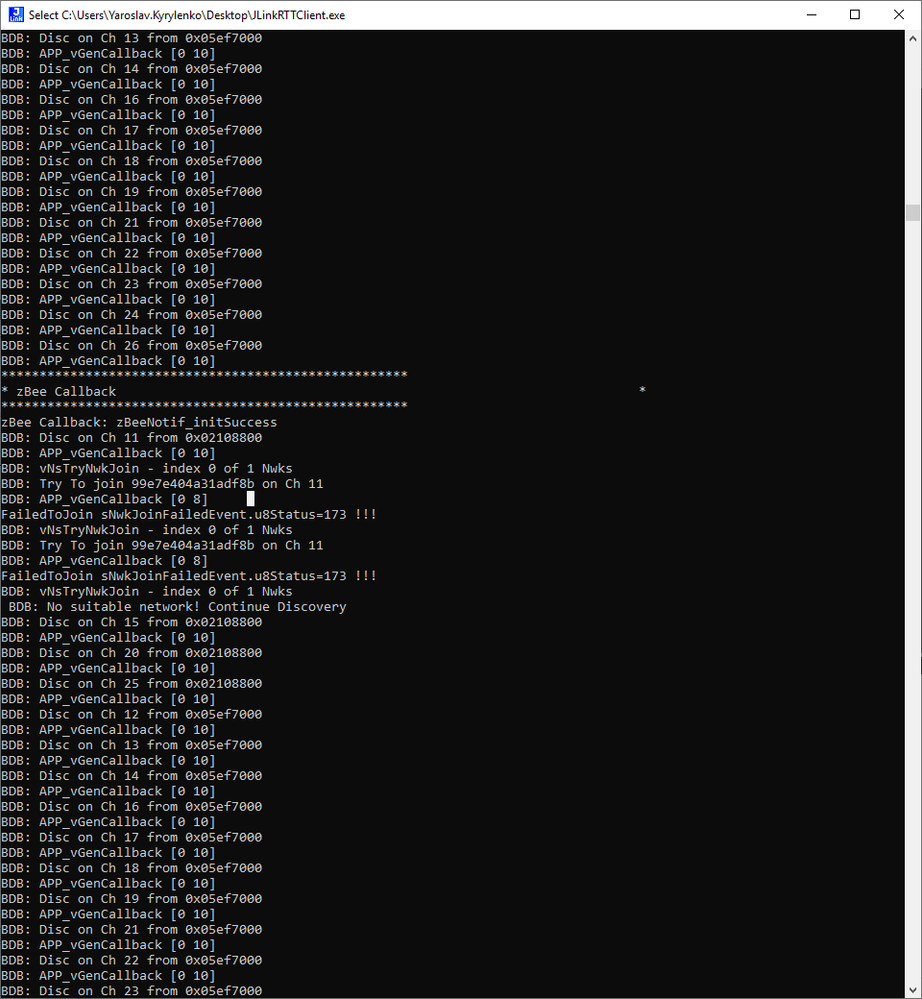

Hi!.
Now I working on the custom implementation  of ZigBee. And I would like to add the security level. I use two devices for debugging. 1. The Coordinator with ble_zigbee_coordinator firmware. 2. My device consists of the router with the capability end device.
To my device, I added the following code:

And added change to app_zps_cfc.h
/*! Specify a type of security */
/*! ZPS_ZDO_NO_NETWORK_KEY/ZPS_ZDO_PRECONFIGURED_LINK_KEY/
ZPS_ZDO_DISTRIBUTED_LINK_KEY/ZPS_ZDO_PRCONFIGURED_INSTALLATION_CODE */
#define ZPS_ZDO_NWK_KEY_STATE ZPS_ZDO_PRCONFIGURED_INSTALLATION_CODE
Also, I added  to the  NXP IoT Toolbox  mobile application, my install code
code 99e7e404a31adf8b
5a6967426565416c6c69616e63653039
But  when I was  trying to connect my device to coordinator I got next errors.
Could you help me with solving this problem?

estephania_mart
We usually recommend that you use the example available in the stack as those are already tested
 Please check the ZigBee 3.0 Stack User Guide available in the KW41Z SDK in the following path.
<installation path>\docs\wireless\Zigbee
Something that I could notice it's that you are not following completely the recommendations of the APIs described in the user guide and yet using some of those functions like the following one. In chapter 5.8.3 Setting Up ZigBee Security
"Security can be set up in the application code using the function ZPS_vAplSecSetInitialSecurityState(), which must be called before ZPS_eAplAfInit()"
As this it's your custom implementation we can't really be sure in which part it is having the issue as according to the error message the link between the node it's not being correctly established, there are those calls not correctly used but in our stack we also have some libraries that you will need to implement in order to make your stack work.  I would recommend you to use the available information and examples in the SDK.
