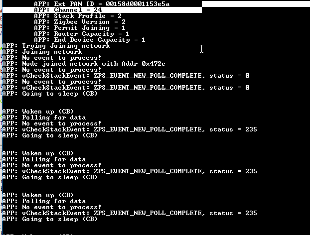

Hi All,
I am using JN-AN-1229 (ZigBee PRO Application Template for ZigBee 3.0).
I have not received association request response to EndDevice by Coordinator.
Issue scenario steps :
1) Start Coordinator application set with E_STARTUP state
2) vStartup API is set as E_NETWORK_FORMATION.
3) Call ZPS_eAplZdoPermitJoining(0xff); API in vWaitForNetworkFormation API.
4) Association request and response pkt received upto 10 minutes.
5) Check traces after 15 minutes but not received any single association request response pkt.
NOTE : Every time,It's reproducible issue
Please reply ASAP.

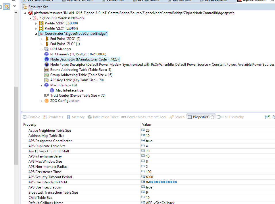

vishal_zadafiy1
Hi Vihang/Mario
I am using JN-AN-1216-Zigbee-3-0-IoT-ControlBridge Application and JN-SW-4270 SDK for JN-5179.
I had set Trust center table size and Aps key Table size is 70  on config file but still i am getting the
tsAplAib->psAplDeviceKeyPairTable->u16SizeOfKeyDescriptorTable is 1 only.
Also i share screen for same.

vihang_jani
Hi Vishal,
Please check zps_gen.h file after save your configuration.
I have attached snapshot of that file for your reference.configuration_of_zps_gen_h_file.JPG

mario_castaneda
Hi Vihang,
I am working on the JN-AN-1229 Version 1002.
1. I set up a single channel. I am working on the channel 24
2. I used the Coordinator example that the AN provide. This creates a network and the permit join.
   Note: You can also work with the control bridge example, JN-AN-1216.
3. The end device joins the network successfully.
As you know, this is only a template, it doesn't have any application, just the wireless connection.
Mario
1,933 Views

I am waiting for you response.
1,933 Views
mario_castaneda
Hi Vihang,
I notice that you are working on the JN-AN-1184, as you know it is an application template and you have to add the DefaultTClinkKey. It will depend on the application if is ZHA or ZLL.
Or are you working on the JN-AN-1229?
Now, you should work with the JN-SW-4168 that support Zigbee Home Automation and Zigbee Link Link.
Then, Could you please take a screen of the terminal of router and end device? I want to be sure what is the issue that is reporting.
Could you please attach the c file that you modified?
Mario
1,933 Views
vihang_jani
HI Mario,
I am working on JN-AN-1229
I also added modified  c file of Coordinator and router.Please you can compare with bare files of JN-AN-1229.
