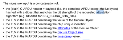

I populate the SE05x with a bunch of data and keys. One of the keys is considered to be the primary device key and can be used for attestation. Now I read back some of those properties and ask for attestation with said key, after which all of the data is transferred to the back office.
According to AN12543, there's a bunch of low level inputs being used as inputs for signature with the selected secure object:
It's clear that none of these inputs cannot be easily generated offline in order to be able to verify the attestation signature. So, the question is, how to verify this in practice? What is the recommended way?

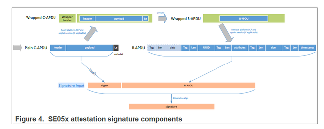

There is no need to generate all of the signature input, you may have them from the APDU command as well as the command response. if you refer to Fig 4 in the same AN, you may find as shown below:
So now you have the signature input as well as the signature which is also a part of the response if the secure object's policy allows attestation, then you may verify them on the host with the public key from the attestation secure object , for example, https://cryptobook.nakov.com/digital-signatures/ecdsa-sign-verify-examples
Hope that helps,
