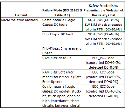

11) No information on the EIM, ECC_EDC safety measures, can you provide this details

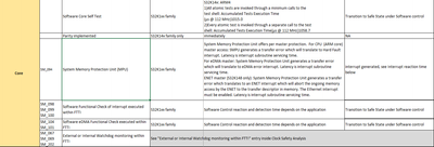

1) In S32k116 which modules are qualified for periodic Low latency interrupt. this is regarding [SM_099] Periodic low latency IRQs will use a running timer/counter to ensure their call period is expected.
2) SM_043 The overall system needs to include measures to monitor error flags in registers of the MCU and move the system to a Safe statesystem when an error is indicated. for the mentioned SM since in S32K116 we dont have external watchdog support should this be not applicable for S32k116 because in the manual it says error out signal only applicable for S23K14X family or can we realize this functionality by other means. Here error monitoring what is the context and which all failures come under this category

- Processing modules might use this timer to measure the interrupt latency
- Any kind of error within the MCU will be reported in status register, and the MCU will switch to safe state. On possible implementation is that the system read the status register for example Via SPI using PMIC or another MCU or other devices,  to assure the safe state of the system at ECU level.

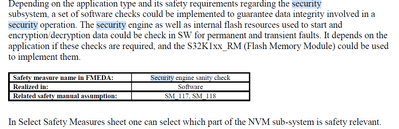

what would be the DC for security engine check

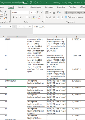

-could you please send a screenshot where you initially found that "System OSC Clock monitoring enabled as per the sheet it's mentioned to be applicable for S32K14X Family "? maybe a mismatch?
-Regarding security engine check question, could you please tell for which failure mode what safety sechanism? within the FMEDA don't you have any information?

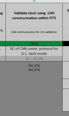

Sushmitha_V
Attaching the screenshot from FMEDA of S32k116 where it says SM_076, SM_075 is applicable

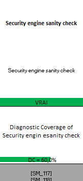

In safety report for S32K116, following SM_117, SM_118 is recomended so if we have to implement this what would be the DC for this SM
@chokor : refer above
491 Views
chokor

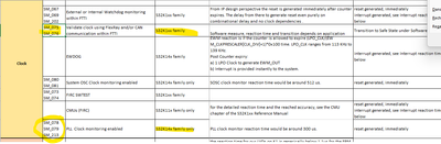

- So, SM_075 and SM_076 are applicable for S32K1XX family. what was mentionned to be applicable only to S32k14x are for different SMs.
Conclusion : SM_075 and SM_076 are applicable with DC 60%
- SM_117 and SM_118 for security engine DC is 60%
994 Views

11) EIM allows to induce single-bit and multi-bit inversions on read data when accessing the System RAM, refer to SM_111. For Error Dectetion Code refer to SM_112. Here are Diag coverages:
