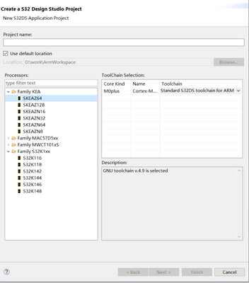

Dear NXP experts:
my EVB is S32K344 and the reason to select K344 is its ASIL-D and other resources.
while creating empty project or 'create project from example', ONLY S32K144 can be found, no S32K344.
my questions , how to upgrade  S32DS For ARM V2.2 to support S32K344?
Could you please give me the upgrade patch link?
It seems the V2.2 is the latest version S32DS for ARM (windows version).
empty project template
thanks and BR
YiChuan

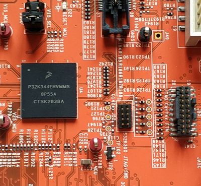

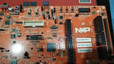

PS : The S32K344 EVB picture and MCU for your reference.

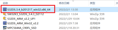

ZhouYiChuan
Hello Petr:
After installing the update package following the training video,  the problem is fixed. thanks again.

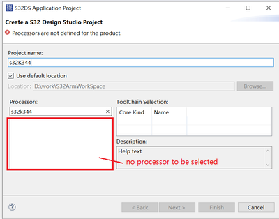

ZhouYiChuan
hello Petr:
S32DS V3.4 was downloaded from the link in your reply, but there is no processor to be selected while 'create S32 DS application projects'
Could you please give me more guide? thanks a lot
the downloaded install package is S32DS.3.4_b201217_win32.x86_64.exe
thanks and br
